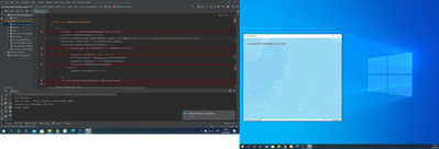

When i use my tif file it loads but doesn't display. The string "raster added" appears, scene is zoomed but i haven't any image displayed. I didn't find tif file from your sample link. I found RasterLayerFile.png file and have the same result when running program with this .png file.
