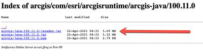

The JavaDoc files are in the same place as the jar files.  So if you are using the latest version of the SDK (version 100.11.0), you can get them from our maven server here:
https://esri.jfrog.io/artifactory/arcgis/com/esri/arcgisruntime/arcgis-java/100.11.0/
We don't publish the source code for the jar files.  Even if you cracked it open you are not going to be able to debug very far into the core logic as this is written in C++ and contained in the supplied libraries compiled for the platform you are running on.
