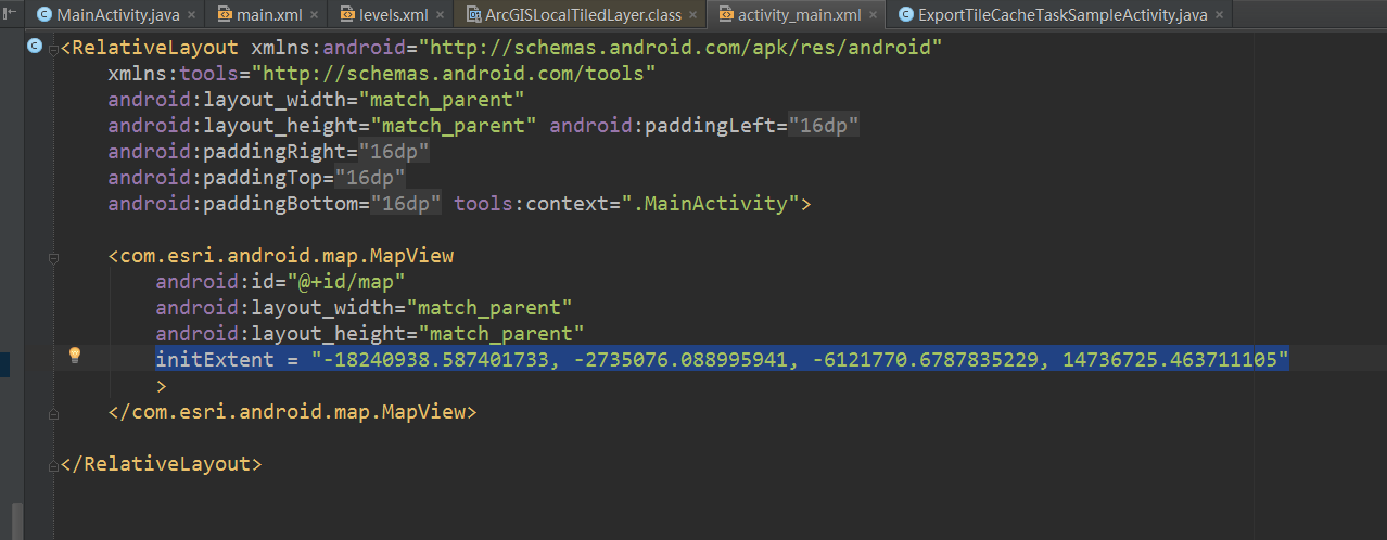

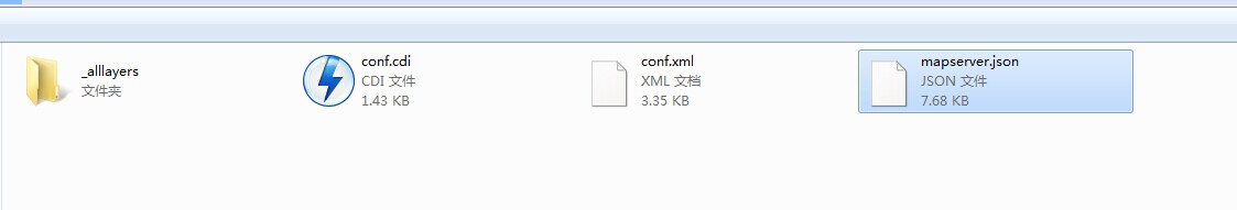

Use the official sample ExportTileCacheTask download tile file;
code
public void onCreate(Bundle savedInstanceState) {
        super.onCreate(savedInstanceState);
        setContentView(R.layout.activity_main);
        map = (MapView)findViewById(R.id.map);

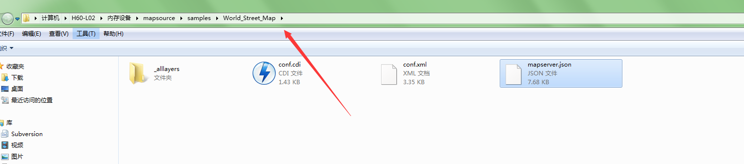

        File file = new File(Environment.getExternalStorageDirectory().getAbsolutePath() + "/mapsource/samples/World_Street_Map");
        String externalStorageState = Environment.getExternalStorageState();
        if (file.exists()) {
            ArcGISLocalTiledLayer arcGISLocalTiledLayer = new ArcGISLocalTiledLayer("file://"+file.getAbsolutePath());
            map.addLayer(arcGISLocalTiledLayer);
            map.enableWrapAround(true);
             map.setEsriLogoVisible(true);
file exist
Q 1. can't show native map ?
Q 2. I have another tile layers file, but it not contain mapserver.json file. so I can't get InitExtent Value ,How get it and set to mapView?

Remove "file://"+
