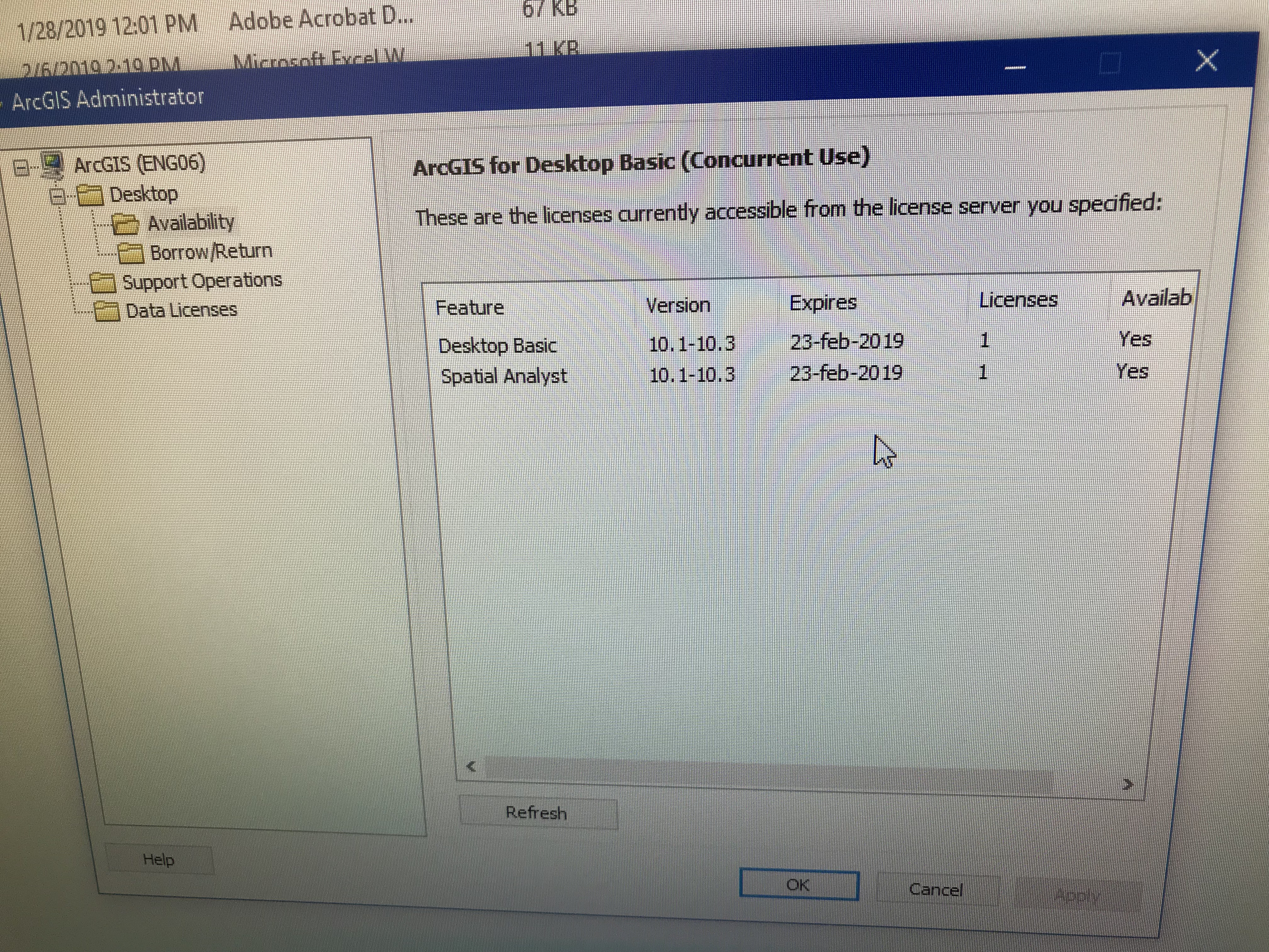

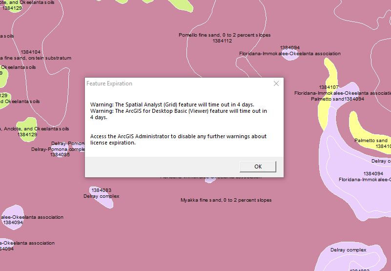

We have ARCGIS 10.3. I moved the license server to a newer server. I deauthorized the old machine in MyESRI, and I authorized the new machine. I go to a work station, and I can borrow the license. On the work station, we get the following error:
Workstation with error
Here is the License Administrator on the work station:
License Administrator on work station

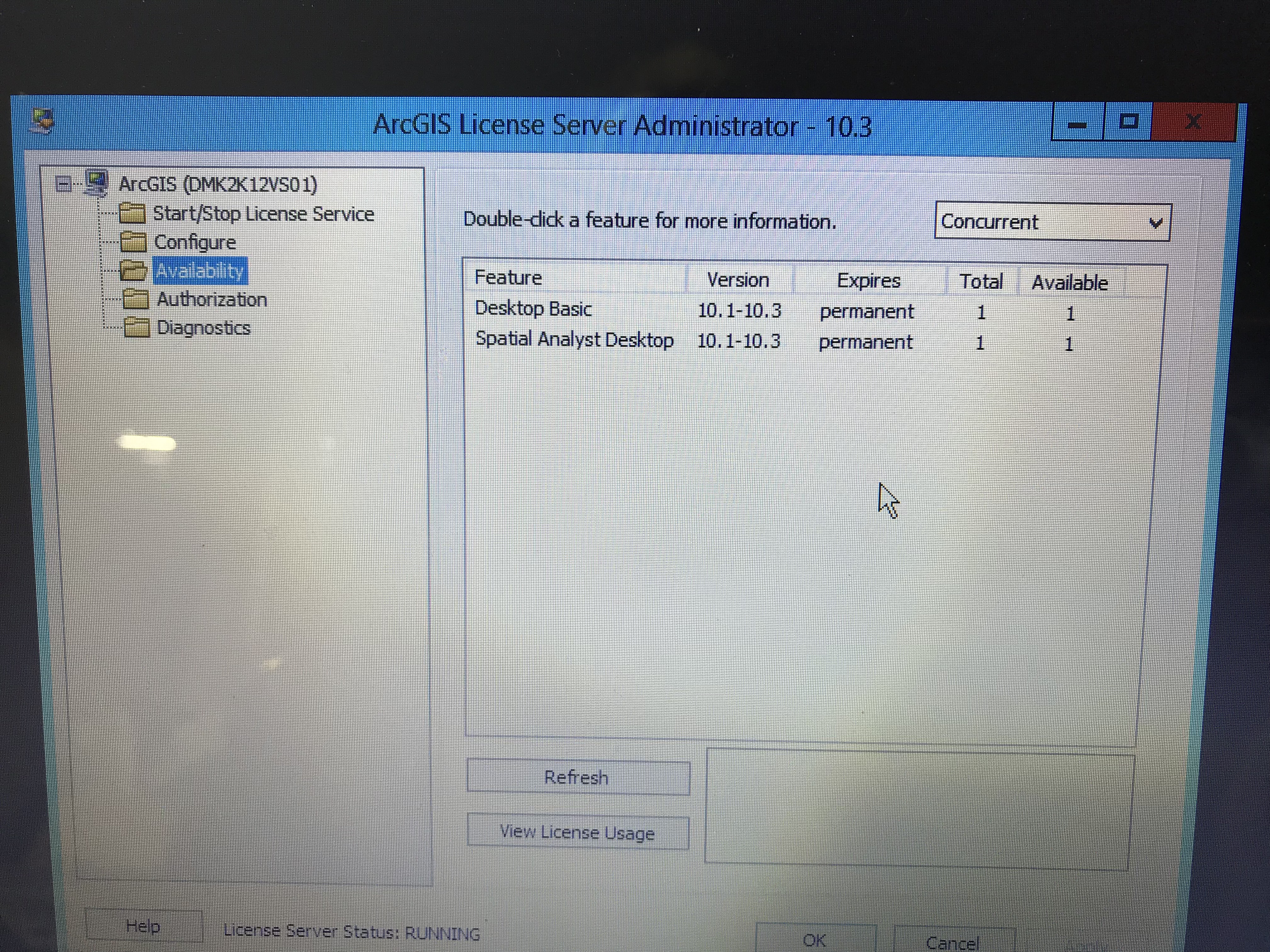

Here is the License Administrator on the server:

I forgot to add that the licenses are set to be borrowed for up to 30 days.
Server showing license available for 30 days

If you navigate on the workstation to the Desktop tab within ArcGIS Administrator, can you confirm that either the hostname or IP address of the new license server administrator machine is located in the License Manager entry?
