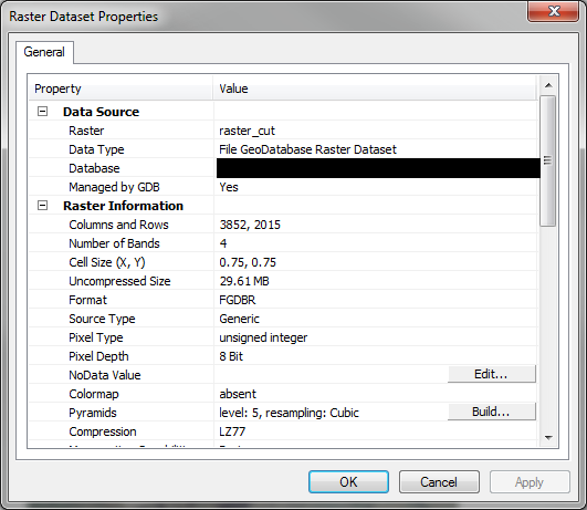

Why when is it that when I project a raster from Alaska state plane zone 4 feet to Web Mercator does the file size increase so dramatically? It starts at ~29MB before it is projected and then increases to ~257MB after projection.
NAD_1983_2011_StatePlane_Alaska_4_FIPS_5004_US_Survey_Ft
WGS_1984_Web_Mercator_Auxiliary_Sphere
The only thing I can think of is that the distortion in web mercator at high latitudes is causing the raster to be "stretched" in some way and then leading to an increase in file size.
Thanks for any input.

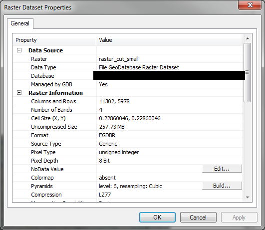

Also, looking at your image, raster_cut_small contains more columns and rows; the cells are smaller, and there's a higher level for pyramids. All of this results in more data contained within the file.

Interesting.  It appears there has been a considerable addition of rows and columns.  The proportional difference in rows and columns is almost identical to the proportional difference in file sizes.  I would symbolize your NoData cells to see if that is where all the extra rows and columns are hiding.

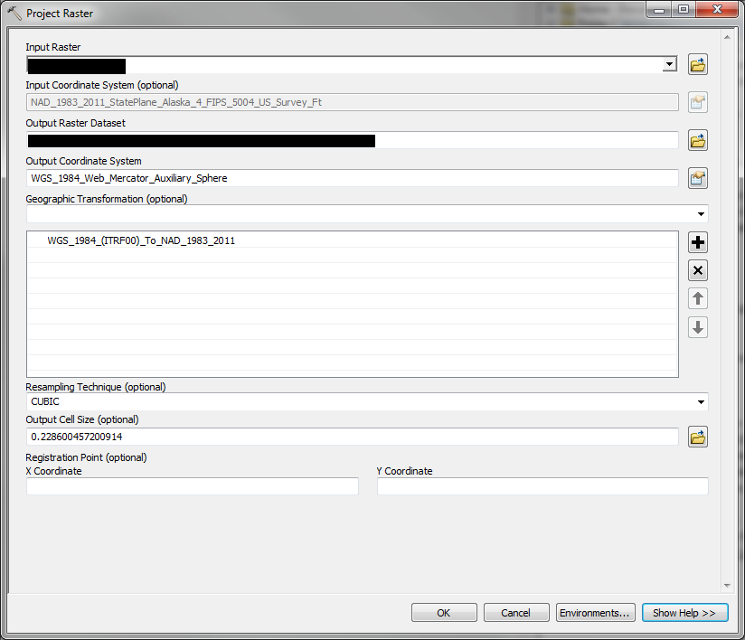

For sure the extra size has to be coming from the increase in rows and columns. But why is this happing? I would think that it would have more or less the same number of rows and columns as the original because:
Which is the cell size that the tool selected.
GabrielUpchurch1
Deactivated User
It appears you are confusing comments by two different people.  You are exactly correct about the cell sizes since there was a conversion from feet to meters between the two systems.  The cells are still the same size so this is not why the datasets are different sizes.
