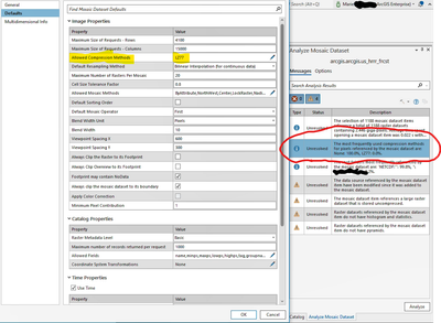

I have a mosaic dataset where the Allowed Compression Method is set to only allow LZ77. However, when I Analyze the mosaic, a message is returned that "The most frequently used compression methods for pixels referenced by the mosaic dataset are: None 100% and LZ77 0%.  Screenshot attached.
Either I am misunderstanding the functionality of Allowed Compression Methods or the property has no real effect on the mosaic dataset.  Does anyone out there in Esri land have any knowledge they could contribute to help me out?

Hi,  I have tried other methods, including JPEG, and the Analysis always returns with 'None' as 100%.
I have radar data in the mosaic.  NetCDF format.

Hey Jon, I have been using Pro 2.9.3 for this particular case and have been using this version in general for quite some time without these issues with mosaic analysis.  However, your comment led me to try Pro 3.1 because I had an install of that version available as well.  And that solved all my mosiac analysis issues.  One analysis and every warning/info issue with stats, pyramids, and compression cleared up and things seem to be running well now.
Thanks for all your thoughts and ideas.
