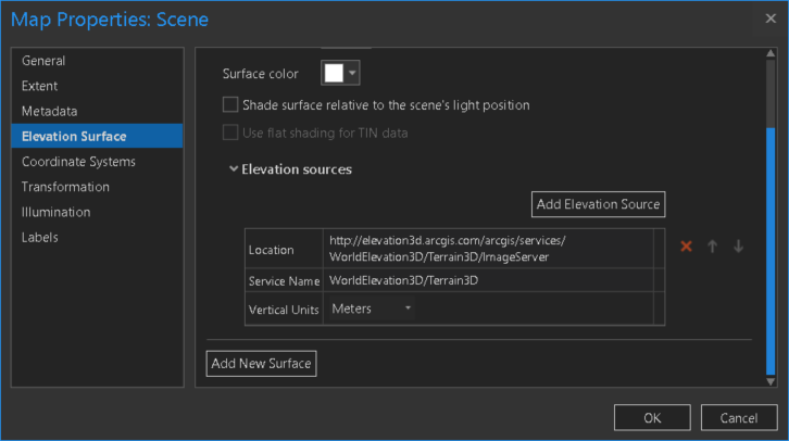

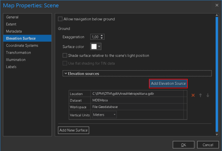

I just followed the steps but not added a new surface, but added an Elevation Source to the default "Ground" definition and removed the reference to the default surface service:
Before (less detail):
After adding my mosaic data source (more detail):
