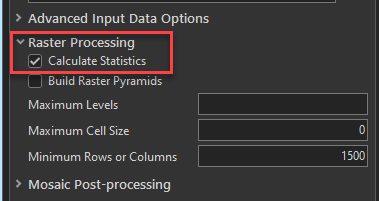

Hi @EricS,
You may need to calculate statistics on the image.  When adding the raster to the mosaic dataset, check the option Calculate Statistics under Raster Processing:
EricS
Yes statistics have been created but it still gives me the issue
