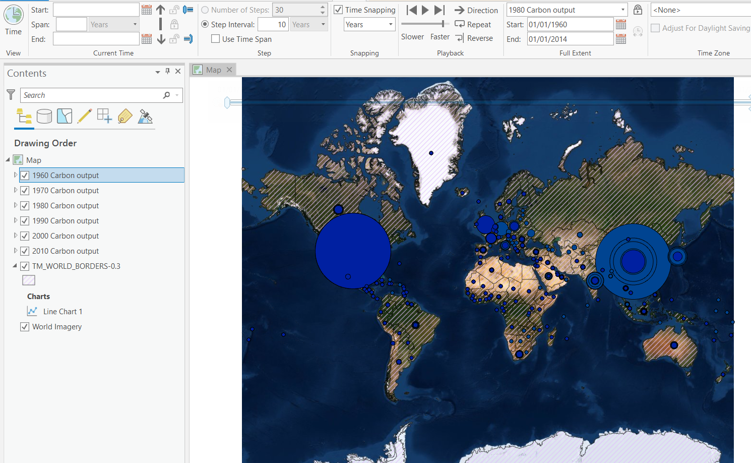

I'm trying to show the increase in the carbon output of each nation through time decade by decade, I have used a table join on the attribute table of a country boundry shape file and plotted the data in individual feature classes
And enabled time on each individual layer, however i'm still having trouble to animate the changes through time

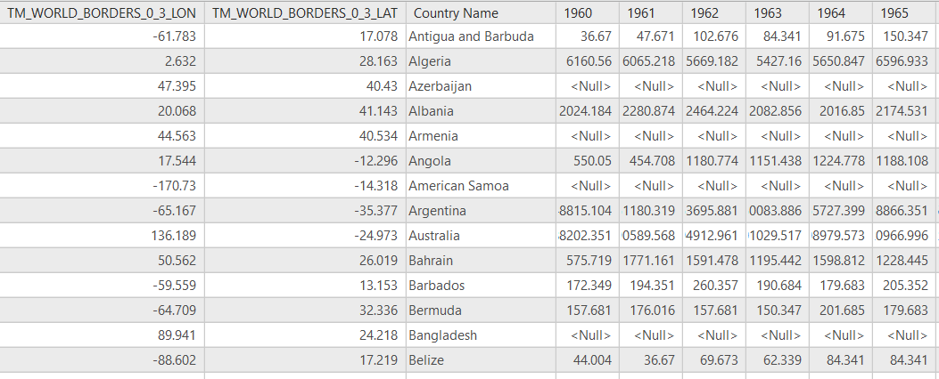

the attribute table for each feature class looks like this

I've saved the classes as a new feature, when i start the time slider the symbology does not change to reflect the new decade i am trying to show, all feature classes are copies of each other just showing a different field from the same attribute table
example of what is happening below:

You need the data to all be in one table not multiple, unless you only wish to show it through each decade.
The problem is that time is not read along the columns, you need to replicate a feature for every time.
