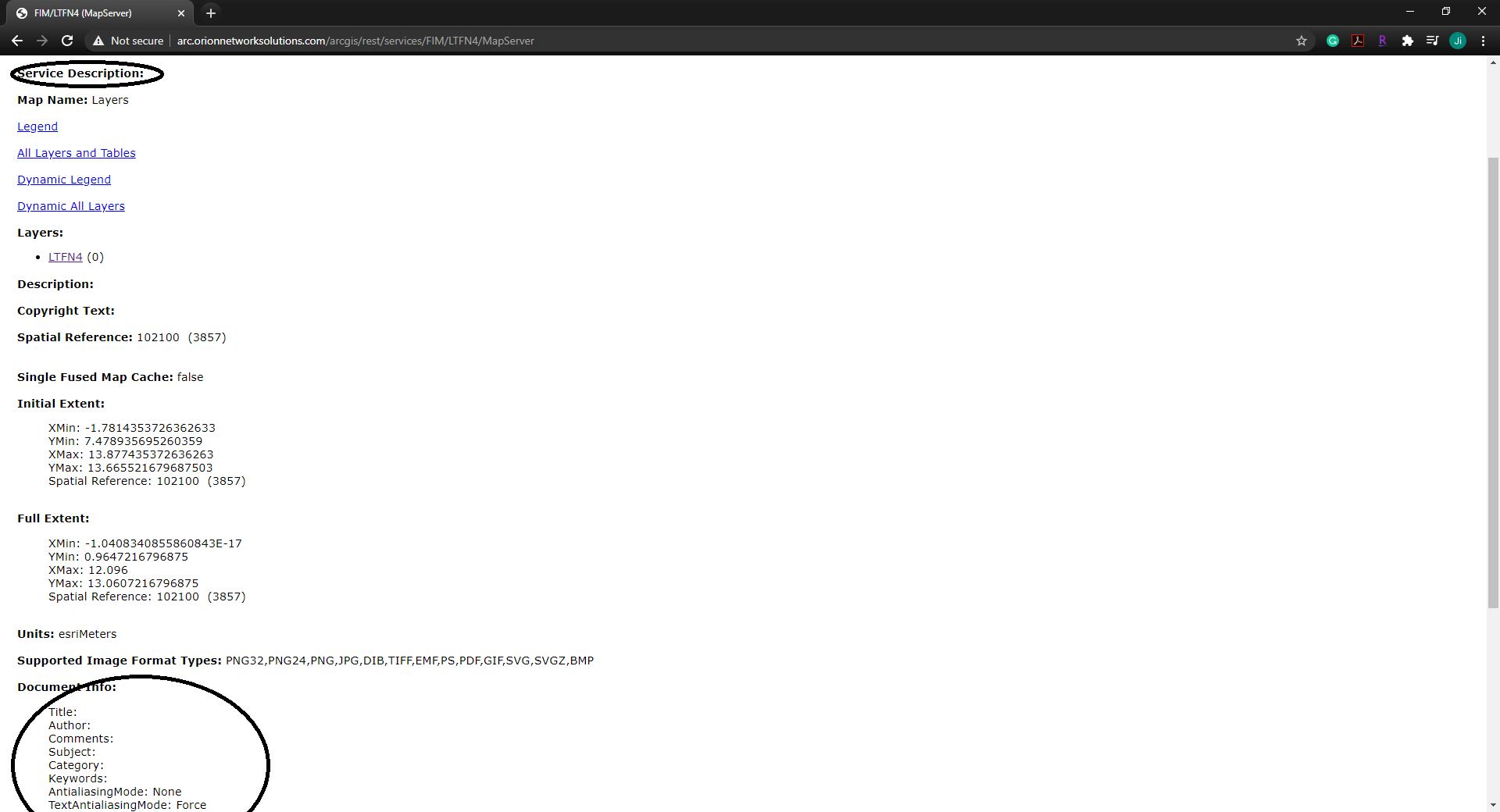

I'm curious to know how to edit the Service Description and Document Info section included in the ArcGIS Server.
More specifically, wherein the mxd file should I modify in order to see the different messages between "Service Description" and the "Comments" section included in the "Document Info".

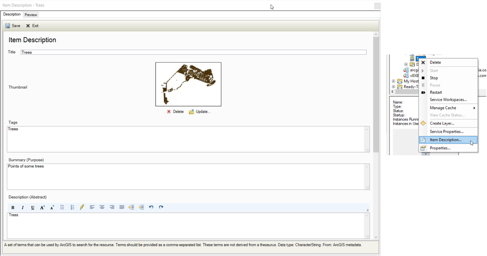

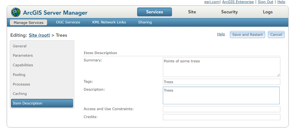

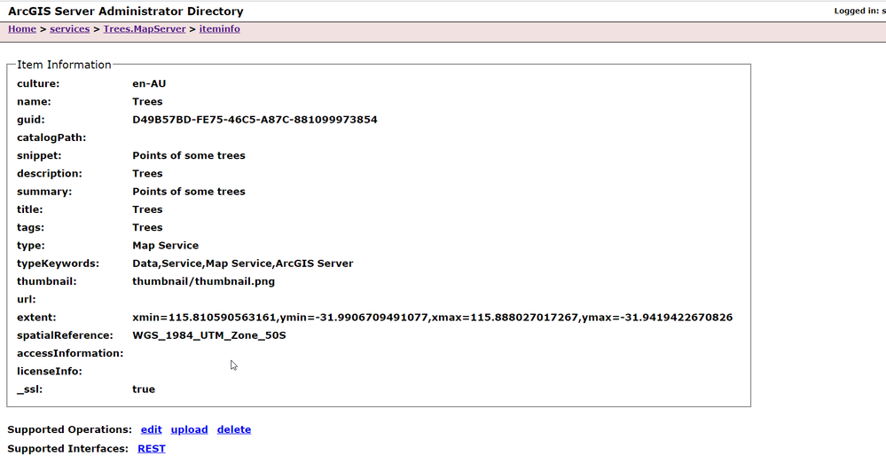

You can edit it via ArcGIS Server Manager, ArcGIS Server Admin or ArcMap:
Hope that helps.

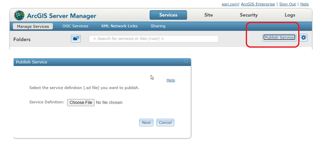

You can publish with SD via ArcGIS Server Manager:

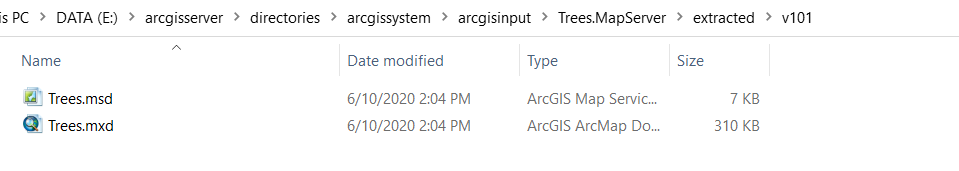

If the service has been published to AGS and if you have access to the AGS file system, you can navigate to:
\arcgisserver\directories\arcgissystem\arcgisinput\XXX_SERVICE_NAME_XXX\extracted\v101 to retrieve your mxd.
