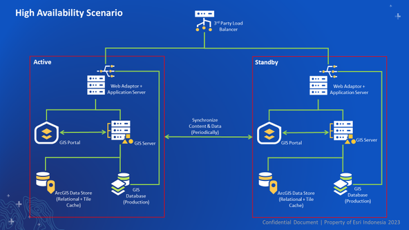

Hello,
Does anyone have experience in implementing active passive high availability in a multimachine environment? The architecture is shown below:
If so, do you have any guidelines that I can read? Because the guideline provided by Esri is not really clear.
Thank you.
Naufal

Hi @MuhammadNaufalIhsan ,
What I recommend doing is using the WebGISDR utility to create a FULL backup, and then INCREMENTAL backups afterwards.  For example, you could create a FULL backup once a week, and then an INCREMENTAL backup each night.  The FULL backup would need to imported into the Passive environment first, and then the INCREMENTAL backup afterwards.
Here is a script example on how to automate a WebGISDR backup.  You could update the script to perform the import as well.

Hi @JakeSkinner
Does it work for all enterprise components (Portal, Server, Datastore)? Does it also work for data from EGDB?

JakeSkinner
Esri Esteemed Contributor
Yes
No, another workflow (i.e. database backup/restore) would be required to keep the Enterprise Geodatabases in-sync.
