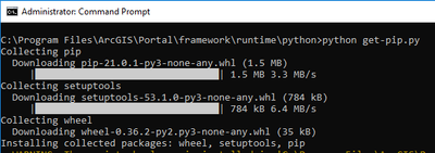

3.  Open a command prompt as an Administrator and navigate to Portal's python directory (i.e. C:\Program Files\ArcGIS\Portal\framework\runtime\python)
4.  Run the following command:
python get-pip.py
5.  After that installs, navigate to C:\Program Files\ArcGIS\Portal\framework\runtime\python\scripts:
6.  Run the following command
pip install python-dateutil

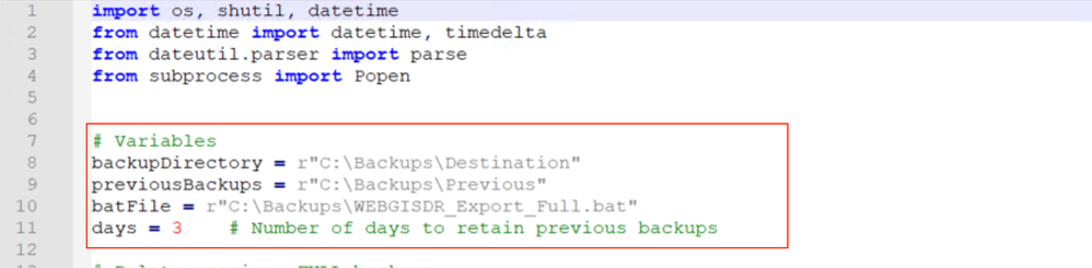

3.  Update the variables in the attached WEBGISDR_Export_Full.py script.
  1. backupDirectory - should be the same as the BACKUP_LOCATION variable in the webgisdr.properties file
  2. previousBackups - a directory of your choose where you can store previous backups
  3. batFile - the path to the updated batch file (.bat) in step 2 that this python script will execute
  4. days - the number of days to retain backups in the previous backups directory

@Izzattry the following to get the dateutil module:
1.  Download get-pip.py to C:\Program Files\ArcGIS\Portal\framework\runtime\python
2.  Open a command prompt and navigate to the above directory
3.  Run the following command
python get-pip.py
4.  After that installs, navigate to C:\Program Files\ArcGIS\Portal\framework\runtime\python\scripts:
5.  Run the following command

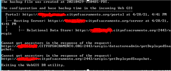

@JakeSkinner What I'm wondering is has anyone experienced this error when trying to run the incremental import?  I ran the full import and then the incremental.  Can't find anything about this error.  It's specific to datastore.
"Cannot get ancestors in the response of the request"
JRaff_CLT
New Explorer
@KrystalPhaneuf2
That issue was a defect at 10.8.1 if you had a Tile Cache Data Store registered to your ArcGIS Server but never took  backup of it when running your webgisdr export. When you went to import your webgissite file back into your Enterprise, you would receive that error.
That is only if a Tile Cache was registered as well as your Relational but you did not backup your Tile Cache Data Store.
