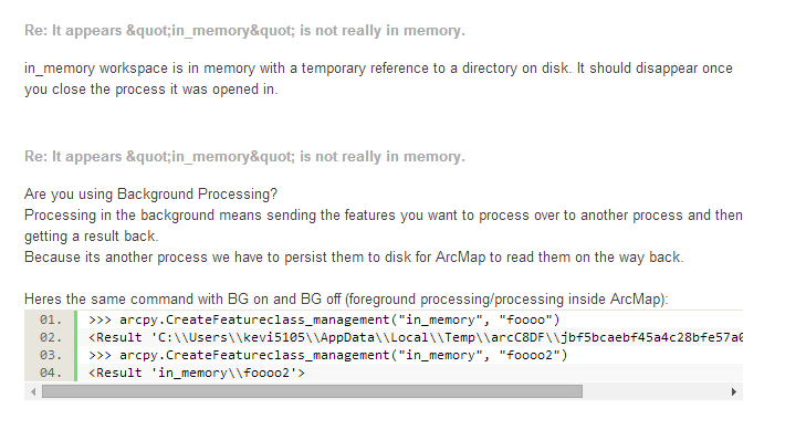

Let's head to the forums to see if someone has posed this question before.  Interestingly enough, someone has asked basically the same question, and more than 2 years ago:  It appears "in_memory" is not really in memory.  There are/were basically two responses in the forum thread, and neither of them appear to be from Esri staff directly.
The first response is a bit incomplete because it doesn't really say whether the statement applies to foreground or background processing, or both.  Since the original poster didn't say whether or not Background Processing was enabled, I am going to assume that defaults settings are being used, which means background processing.  I did a quick check using the Mosaic to New Raster tool with Background Processing turned on and turned off.  With Background Processing turned off, the in_memory raster consumed roughly 400 MB of RAM.  With Background Processing turned on, the in_memory raster consumed about 120 MB.  There may be some memory mapping occurring when Background Processing is enabled, but it surely isn't loading everything to RAM and just keeping a reference on disk.
The second response makes sense, but it isn't completely accurate because we can find tools where in_memory stills means in-memory even when Background Processing is enabled.  CreateFeatureclass might work the way the reply states, but CopyFeatures surely doesn't.  So, how do we know which tools work which way?
