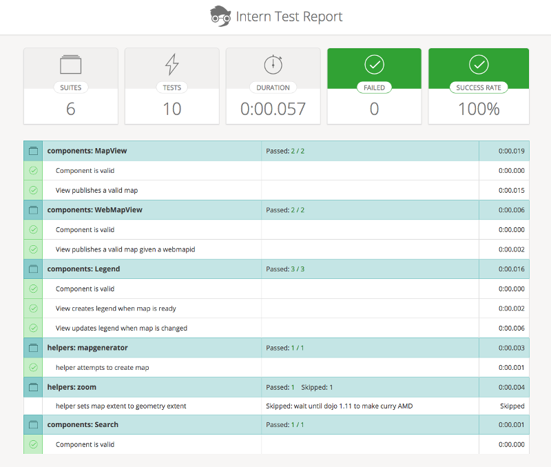

You write badass apps. Your users are happy, you're happy, everything is peachy. Someone says they want some new features. You're like rad dude, I got this. You start writing and refactoring, adding new modules, tweaking a couple of others and somewhere along the line your entire application comes crashing down. Something broke and you've made so many changes you can't tell what broke where.
You are so screwed.
Maybe you've never been in such a horrible scenario, but I bet you've had to do some ugly stuff in your code to make things work because you needed to work around some weird issue that popped up while adding new features.
The shame
As developers, we all feel like we should do it. Maybe we start a new project with enthusiasm doing it. We should be testing our code. I'm guilty of starting a project with lots of tests, but somewhere along the way I don't keep it up and I feel horrible about it. But it doesn't have to be that way. Unit tests are appropriate for large projects, trust me. Maybe it's TDD or BDD or you just write tests after the fact. However you do it, you will only thank yourself down the road as a project grows.
Here is a repo on testing from previous Esri Dev Summits and a cool Karma example. I like Karma, it's a cool test runner, but recently I've revisited TheIntern for testing. Intern is really cool and you can read some really great posts on SitePen about it. Check out the one on InternRecorder which is awesome.
Simplify your flow
The only drawback on Intern from something like Karma that I could never get to work is have it run my tests in the terminal on every file change, but I've worked around that using live-reload in my development toolkit.
Combine live-reload with Grunt and a few plugins and every time I make a change to my app, my app reloads in the browser and my test page also reloads so I can instantly see if I broke something.
Green is a beautiful color.
Now I'm not going to get into the whole red/green/refactor bit of tdd or unit testing. There are plenty of tutorials out there to help you out with that. There's also a whole world out there on spies and mocks for testing. I'll just say that I like SinonJS for this purpose. I know it and I'm used to it, but others may have different preferences.
So what's a sample test look like? Like this maybe.

All that noise basically boils down to this.
'View publishes a valid map given a webmapid': function() {
  mapView = new View({
    webmapid: config.webmap.webmapid
  expect(mapView.webmapid).to.equal(config.webmap.webmapid);
I'm basically saying that when I create this component, I expect it to have a webmap with the webmapid I gave the constructor. That's it. The implementation is left up to me, but the test is only concerned about the end result.
