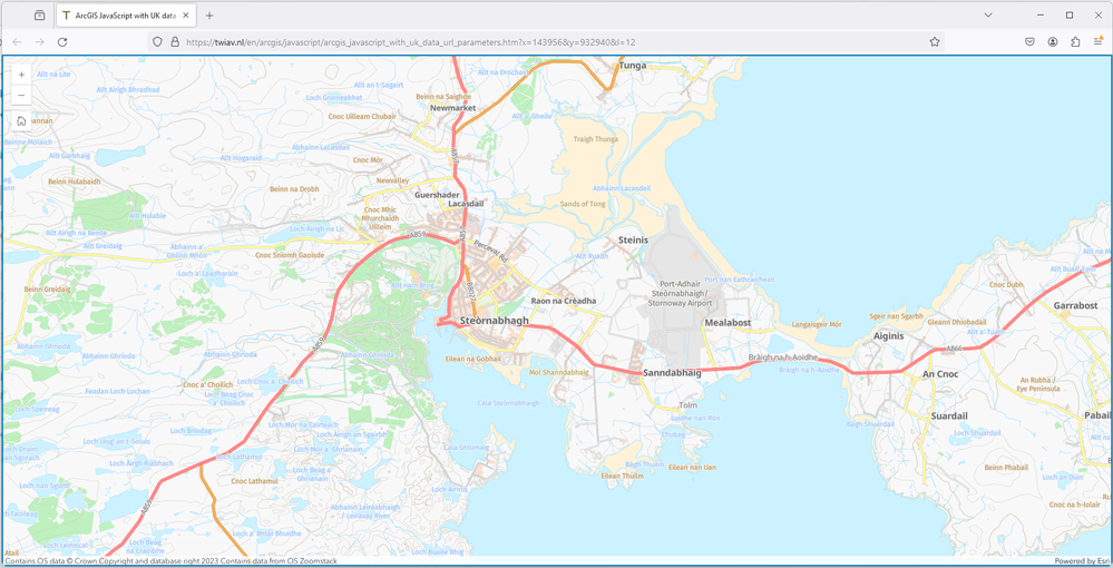

If you provide the url without any parameters, you will start at the Default map view. But as you will see, the default parameters are added immediately to the address bar:
https://twiav.nl/en/arcgis/javascript/arcgis_javascript_with_uk_data_url_parameters.htm
And as soon as you start zooming and panning around, these parameters will be adjusted every time the view becomes "stationary" (we do use reactiveUtils to check the state of the view, stationary or not),
In this way, you can zoom in to a particular spot and copy the url to make sure to share exactly that map view.
If you click on the link below you will immediately end up in Steòrnabhagh  (or Stornoway in English, we are using the Web Map GB Cartographic Local Names here), on the island of Lewis and Harris in the Outer Hebrides:
https://twiav.nl/en/arcgis/javascript/arcgis_javascript_with_uk_data_url_parameters.htm?x=143956&y=9...
