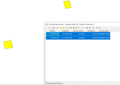

yes here is a sample csv. thank you.

FromWKT() can be used using ArcPy, a sample explained in the comments of Utilizing 'fromWKT' function in python in version ... - Esri Community.
However, if you have QGIS, it could be pretty straightforward using "Add Delimited Text Layer" tool.

Thank you. I ended up downloading Qgis just to do this. I find it strange that ArcGIS doesn't have a tool for this, although I guess arcpy works well for those familiar enough with it.
