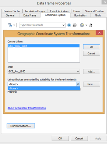

When using the project raster or project vector tools there are no suggestions for datum transformations. Digging further I checked an existing map and tried to add a transformation to the data frame. The screenshot shows that no transformations are available.
It would appear that they have been deleted. Is there a way to reinstall them without having to reinstall Arc completely?

Yes they were there. I have hundreds of .mxds and often need to apply transformations. Recently between WGS84 and Arc1950. Looking back over the last week's work I realised that in cleaning up my machine I had uninstalled ArcEarth and Arc App Studio. Presumably the uninstall from one (or both) of those two was a little overzealous and took all the transformations with them.
In order to fix it it was as simple as Control Panel > Programs and Features > ArcGIS 10.4 > remove / change > repair
Now they're all back.
Success.
