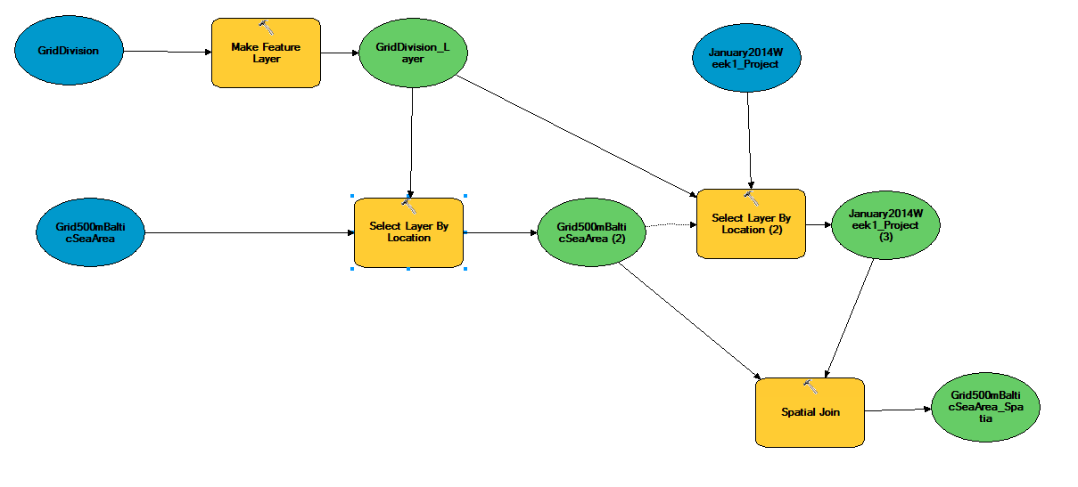

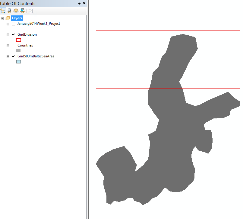

I created another grid with 9 big cells which cover the whole area. The idea is to do the spatial join in each big cell and then merge everything.
This model works like a charm for one big cell:
It works fine for one rectangle (only 24 min!) but how to iterate to do the same in the rest of the cells? I exported it from Model builder (attached) and tested a for loop but to no avail.

Since you are already using ModelBuilder, I would just insert a "Feature Selection" iterator prior to the Make Feature Layer step and use the 9 cell grid feature class as the input.  The output from the iterator is then used as input to the Make Feature Layer tool.
Some documentation on iterators:  A quick tour of using iterators—Help | ArcGIS for Desktop
You will also need to use "inline variable substitution" to properly name the outputs from each iteration.  Here is some documentation:  A quick tour of using inline variable substitution—Help | ArcGIS for Desktop

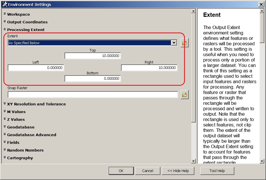

The Environments... settings of the Kernel Density tool (and Line Density, and all other tools) provide a way to specify the origin of the Processing Extent:
You may need to enter the top/right values before the left/bottom, since the UI enforces a valid envelope (right > left, top > bottom) at all times.

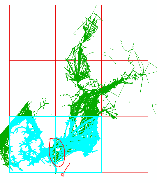

The problem is that Spatial Join is unable to join the polygons and the lines of the first part, That is about 600 000 polygons and only 4 500 lines. Out of memory!
This happens if I use Intersect for Select Layer by Location (2): the lines and the GridDivision.
If I use within the process goes until grid cell 7. The problem is that with withing not all lines get selected.
