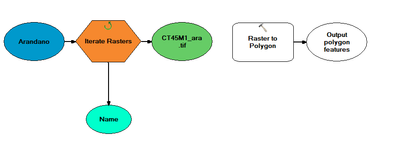

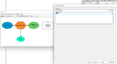

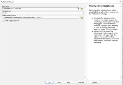

Hello,
I'm trying to use an iterator in model builder to transform a raster into a polygon but with another Field than Value. This field was named the same (combine) in every raster inside the folder (Arandano) and it is a short integer, but when I want to select it inside the Raster to Polygon it only appear the Value field. When I don't use an iterator it appear the combine field. Does anyone know what can I do? I don't wanna do it one by one.
With the iterator:

Without iterator

SteveLynch
in ModelBuilder, click on Iterate Rasters graphic and run only that part of the model. Is the short field now available in RasterToPolygon?

SteveLynch
DanielaArayaOsses
yes!! thank you! 😁
SteveLynch
By the way, this done not happen in ArcGIS pro.
DanielaArayaOsses
yeah, I bet it doesn't. Thanks anyway!
