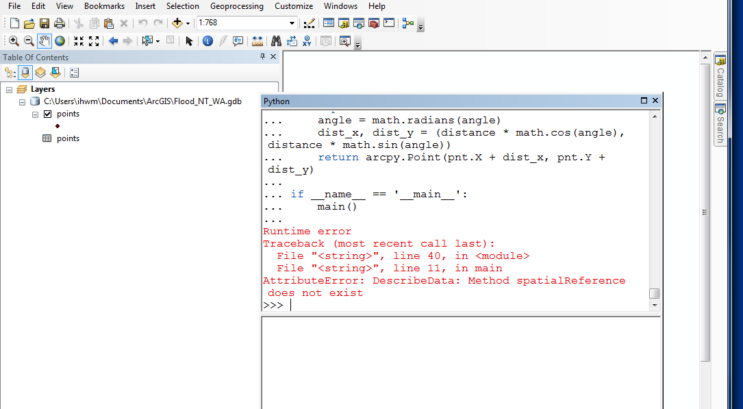

Thanks Dan.  I really appreciate the quick response.  I changed the lines to include the field names, but I still receive the below error message:
Runtime error
File "<string>", line 40, in <module>
File "<string>", line 11, in main
AttributeError: DescribeData: Method spatialReference does not exist

Runtime error

Thanks, Darren!  I'm still getting the same message.  Could it be because I'm using Arcgis 10.4.1 and that code was written for an earlier version?

Runtime error

Are you sure 'points' is a feature class and not a nonspatial table, that wouldn't have a spatial reference?

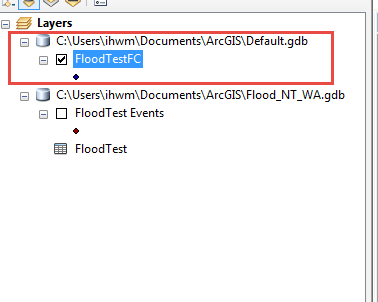

Hi Darren,
Thanks again for all your help.  I started over, taking a subset of my data and creating a feature class layer of 500 points saved in the Default gdb (FloodTestFC).
This is the code I use:

And this is the error message:
Runtime error
File "<string>", line 31, in main
File "c:\program files (x86)\arcgis\desktop10.4\arcpy\arcpy\management.py", line 2335, in CopyFeatures
raise e
RuntimeError: Object: Error in executing tool
