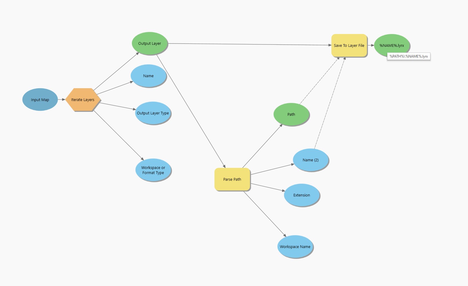

Hello,
I'm trying to create a model builder to save the layer file (.lyrx) in the same path of the data source.
Using the parse path the output path is the project folder and not the data source folder path.
here below an image of the model builder.
Someone can help please.

RichardHowe
The iterate layers tool will return that path as that;s where the layer lives.
If you want the actual data source then look at making a workspace (the folder containing your data) your input variable (rather than a map) and iterating datasets then parsing that path.
Alternatively have a look at python and listLayers, which will give you much more flexibility and the ability to interrogate all the layer properties, including data source.
FabioTuccini
Thanks, but using the iterate workspace I can't use the tool save to layer file.
RichardHowe
Ah yeah, that;s fair. I would definitely look into python then. I realise it can be daunting at first, but honestly once you get going and you see the possibilities, you'll never look back at model builder.
