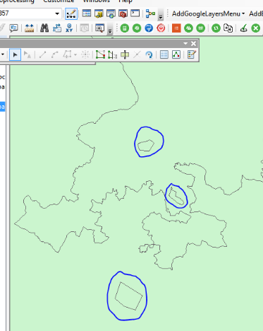

i have work in arcgis 10.2. there i have a query to merge that polygon who are completely within
the big polygon in just one click.
i have a polygon feature class
Please see below snapshot.
here i want to merge highlight small polygon that are completely within the big poly.
Thanks in advance
Kapil

Did you check Eliminate?
Before using Eliminate, you need to select the smaller polygons you want to merge. Maybe you can use "Select by attribute" based on the area of the polygon. Use your reason to unselect any unwanted polygon.

thanks for this. but i want merge multiple boundaries that are intersect by different different location.

Can you explain the 'just one click' requirement then?
kapildev
i want to use this process in model builder. so i told in one click..
DanPatterson_Retired
MVP Emeritus
If none of the previous solutions work for all cases under all conditions, then you may have to reformulate a solution.  Can you report on how the suggestions so far have either succeeded or failed to meet the requirements?
