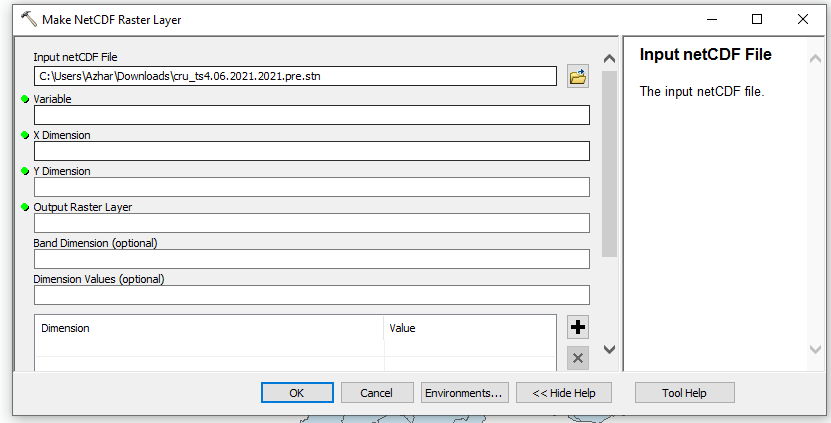

When I insert NetCDF file, I do not get drop-down menu on all the boxes below, what could be the problem, without selecting Coordinates and time dimensional operation cannot be completed.

could be you missed this requirement
This tool supports netCDF files with .nc and .nc4 extensions. The group variables and dimensions within a group in a .nc4 file are not supported. Only the variables and dimensions outside of the group are supported.

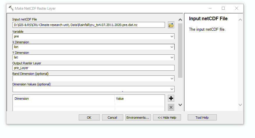

IzharAhmad
After the suggestion of  DanPattersonmy problem gets solved.
