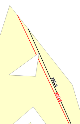

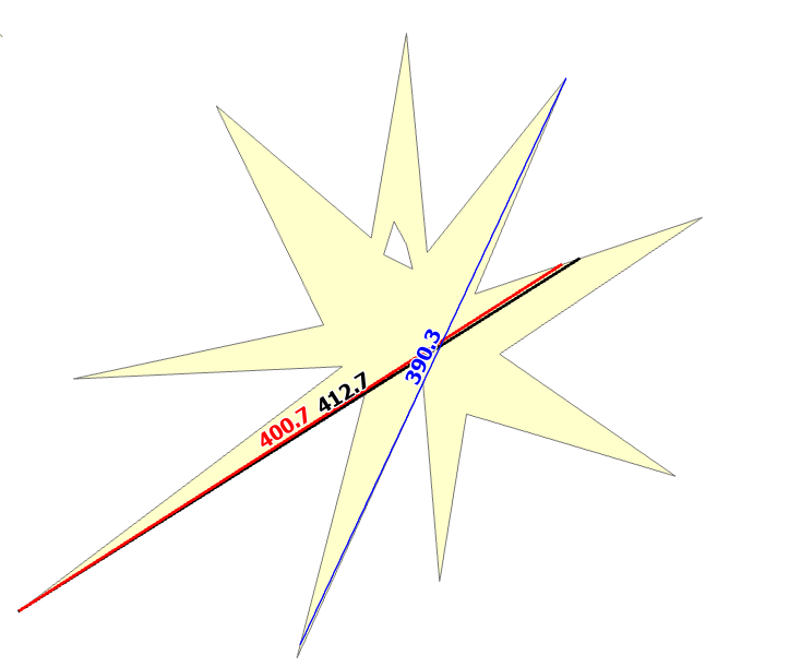

My longest line (measurements all in US Feet) is shown in Black, yours is in Red, and my (I am now realizing) incorrect "entirely internal" line is shown in Blue. So, disregard Blue, I need to remove that feature.VinceE_0-1681507257472.png

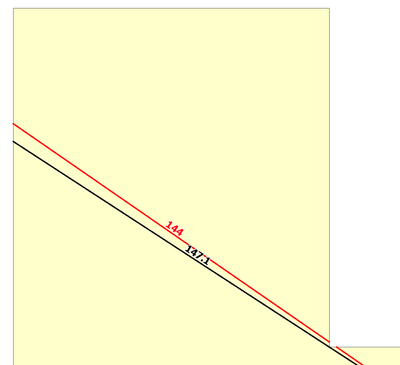

For absolute accuracy, I think my two-vertex algorithm is the best approach, but for realistic use on complex polygons (islands, parcels, etc.) your approach could likely get pretty darn close, and probably requires far less processing time. Another exampl--again, mine in Black, yours in Red:
Another thing to watch out for with your toolbox would be holes in polygons, as well as concave polygons. As you can see, your line is "longer" here, but passes through a hole. The second image shows your line going out of bounds in a concave polygon.
