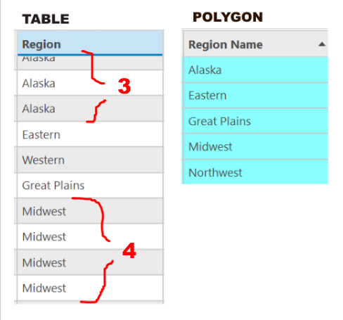

I have a table with a 'Region' field that a want to join to a Regions feature class. The regions feature class has one value for each region. I would like to join the regions table to the feature class so that there is a polygon for each associated region in the join. Since of values in the table could change, I need to be able to do this within the join. Has anyone had any luck doing something like this? I'd tried a few different things, but none provide the desired results.
To clarify, if the table has three records for the Alaska region and I'd like to join it so that there is an Alaska polygon is associated with all three records.
Dale_Honeycutt
Make Query Table will do the trick here.  It's been a loooong time since I've used it, so if you need help with the input parameter values, I'll need to set up a test case.
Dale_Honeycutt
DuncanHornby
MVP Notable Contributor
To add to Dales answer you probably want to export the data to make it permanent otherwise it only exists as temporary layer in the map.
