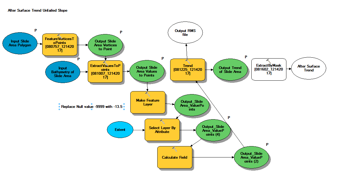

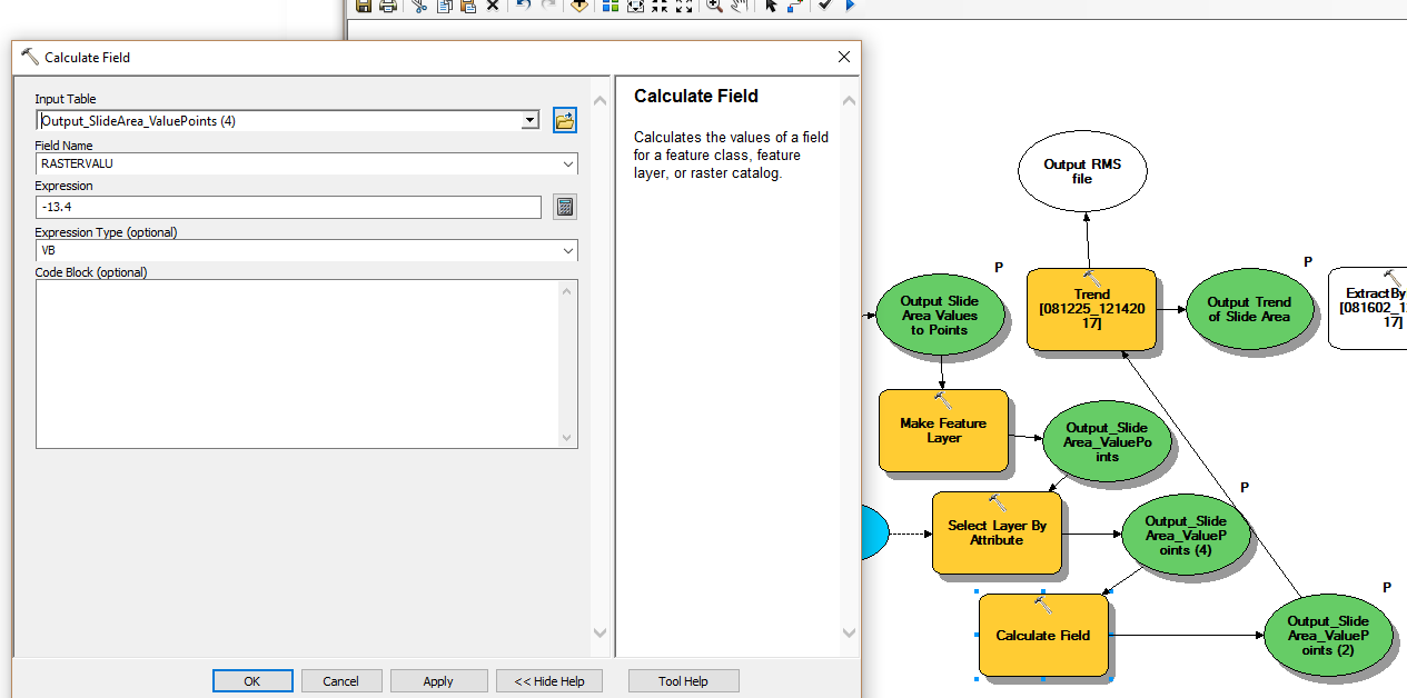

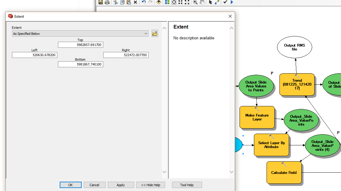

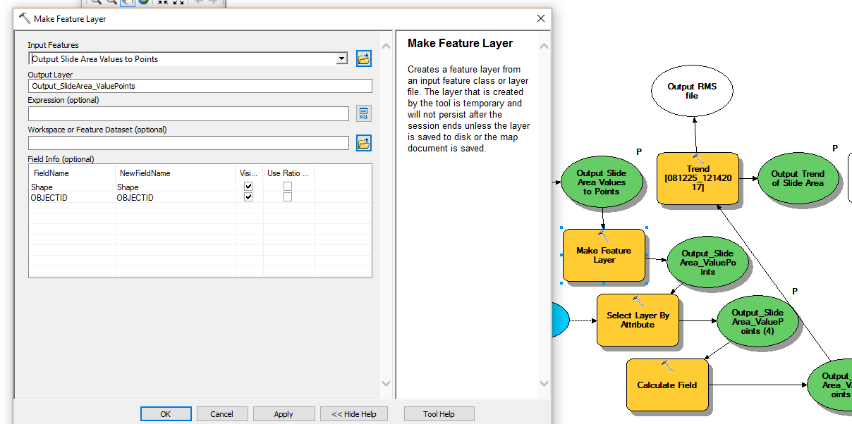

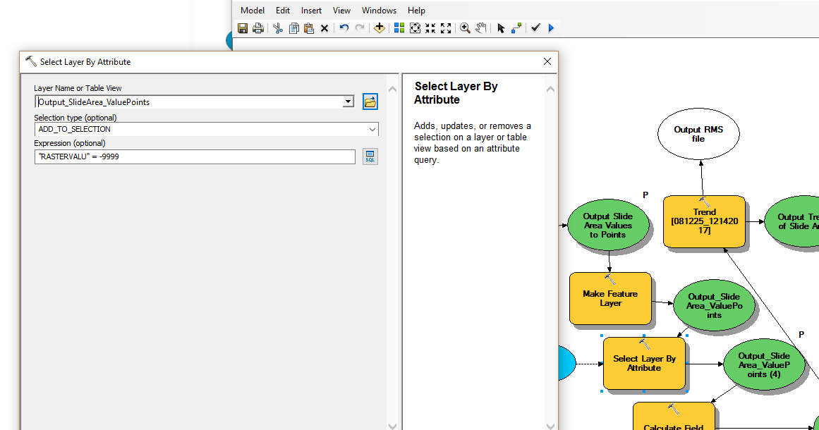

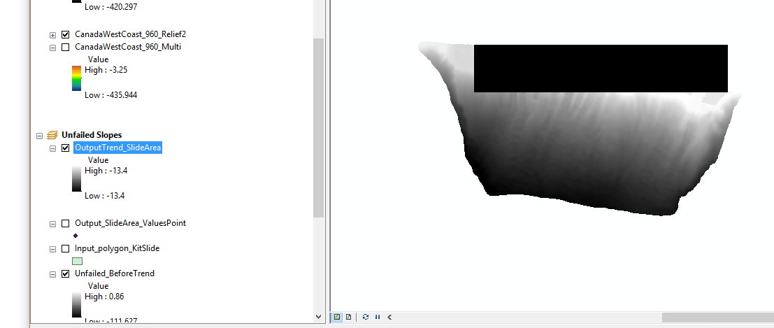

I understand...I think...what you are saying. However, I feel like this is what I did. I tried again this morning but i still only gives me the replace section. I can not see in the Selection by Attribute any way to replace the null values and retain all other values. Am I missing something??? Even when I specify the full extent to include the polygon area, it still is only giving me the section with replaced null values.
Please see my steps below. Can you see where I might be missing something.
