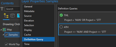

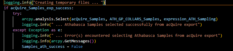

So, we have Samples geodatabase that contains the feature class, and we use two set of expression with
arcpy.analysis.Select to generate two feature classes from the dataset.
The expressions when used within ArcGIS Pro (Notebook, geoprocessing tool, definition query) works as intended.
But the same thing started failing since last week as seen from the log file
Now this the very first function of the script and it has been failing, strangely enough if I am run the whole script from Notebook there are no error

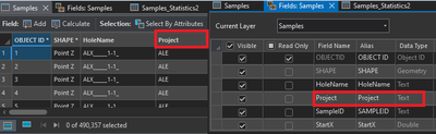

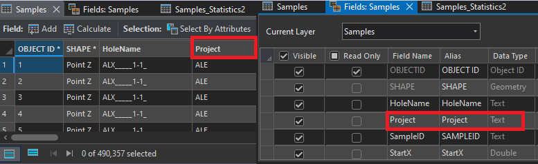

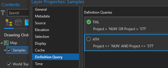

I checked the geodatabase and there seems to be no change in there. The script basically creates temporary feature class, adds new field, populate the new field and then finally delete the feature class in sde and append the data from the temporary feature class to the sde.
 The other function doesnt even get to run as the failed select function finishes the script.
I mean the sql expression works on definition query, notebook and the sql is valid. We use sql server as our sde so uppercase/lowercase doesnt matter. Have been using python f string so that python doesnt mess up single quote/ double quotes.
