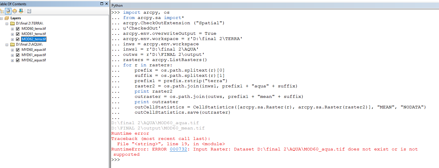

JohannesBierer
Don't know if it could be the reason, you are using spaces in your paths: ...\final 2\... . What if you use ...\final_2\... ?
ravitejaSETTIPALLI
i tried by removing spaces,but not working sir
JohannesBierer
JohannesBierer
It can't work because you use different prefix. MOD60_ is not the same as MYD60_. So you could rename MYD60_ to MOD60_ etc. and it should find the rasterdata? Or use replace() in you script?

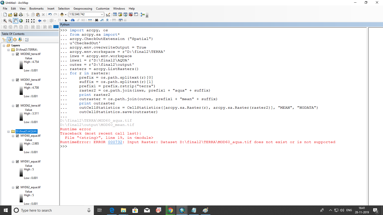

ravitejaSETTIPALLI
>>> import arcpy, os
... from arcpy.sa import*
... arcpy.CheckOutExtension ("Spatial")
... u'CheckedOut'
... arcpy.env.overwriteOutput = True
... arcpy.env.workspace = r'D:\final2\TERRA'
... inws = arcpy.env.workspace
... inws1 = r'D:\final2\AQUA'
... outws = r'D:\final2\output'
... rasters = arcpy.ListRasters()
... for r in rasters:
...     prefix = os.path.splitext(r)[0]
...     suffix = os.path.splitext(r)[1]
...     prefix1 = prefix.rstrip("terra")
...     raster2 = os.path.join(inws, prefix1 + "aqua" + suffix)
...     print raster2
...     outraster = os.path.join(outws, prefix1 + "mean" + suffix)
...     print outraster
...     outCellStatistics = CellStatistics([arcpy.sa.Raster(r), arcpy.sa.Raster(raster2)], "MEAN", "NODATA")
...     outCellStatistics.save(outraster)
D:\final2\TERRA\MOD60_aqua.tif
D:\final2\output\MOD60_mean.tif
Runtime error
  File "<string>", line 19, in <module>
RuntimeError: ERROR 000732: Input Raster: Dataset D:\final2\TERRA\MOD60_aqua.tif does not exist or is not supported
DanPatterson_Retired
MVP Emeritus
have you done it manually with one raster?
