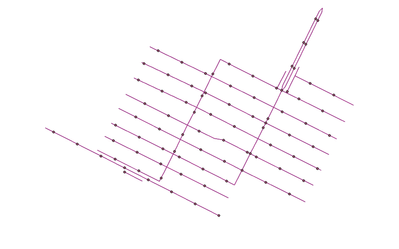

DarrenWiens2
MVP Alum
Arcpy implementation (then Split by Lines):
>>> fc = "YOUR_LAYER_NAME"
... points = []
... step = 2 # map units
... sr = arcpy.Describe(fc).spatialReference
... with arcpy.da.SearchCursor(fc,"SHAPE@", spatial_reference=sr) as cursor:
...    for row in cursor:
...        for i in range(int(row[0].length/step)):
...            point = row[0].positionAlongLine(i*step)
...            points.append(point)
... arcpy.CopyFeatures_management(points, r'in_memory\points')
