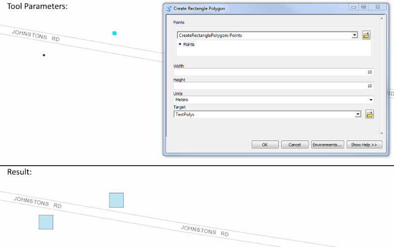

OwenEarley
So in-essence, whenever a user clicks the map and has this process active, what would this calculation look like knowing the XY from the mouse click?  It is important that the size of the new polygon feature matches the map (size = 10 Feet by 20 Feet). Thoughts?
You can do this using a python script in a custom toolbox.

The script takes the following inputs:
  • User Defined Points (Feature Set)
  • Width (size in units)
  • Height (size in units)
  • Units (Meters or Feet)
  • Target Feature Class (new polygons are created in this)
See this zipped example with toolbox, script and template point feature class (required for feature set parameter).
Note that this example uses the WGS 1984 Web Mercator (auxiliary sphere) projection – so you should use this in your target feature class as well.
Owen
Spatial XP
OwenEarley
Forgot to add - this is how it looks in ArcMap:
