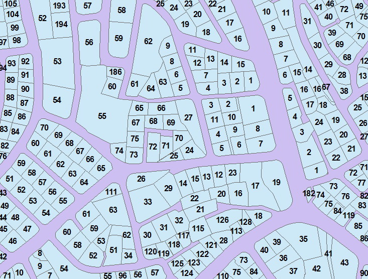

I have a parcel featureclass that I want to classify it according to the number of edges the parcel shares with the road like in the image below:
However, the real life parcels are not as uniform as in the figure above, the screenshot below shows the irregular parcels I have that should be subjected to a certain kind of analysis which can determine how many edges each parcel shares with the road.
Any suggestion about how this can be done?

Hi Hani,
I would recommend taking a look at the Simplify Building within the Cartography toolset:
Thanks Jake,
I explored the Simplify Buildings tool, its an awesome tool, but I need a more advanced technique

Its quite similar to what I'm looking for, seems that jamal is working on a similar assignment
