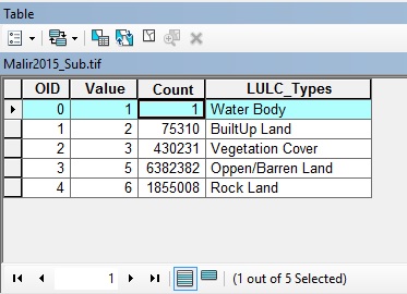

I am getting an error 999999, failed to execute (weighted overlay), while running weighted overlay tool. i selected 6 raster data layers (factors) with tiff format.

For me this error is frequently resolved when if I select to save to a
geodatabase, but as Dan points out, there could be many reasons.

Problem solved..  . there was a single number value in a water class of landuse. I reclassified (merged into Open land) it and then ran again weighted overlay tool successfully.
