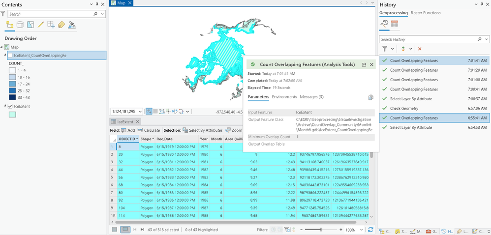

I am unable to reproduce what you are seeing with Month = 6 selected on the IceExtent feature class.  Below is how I ran it... using the downloaded FGDB from the tutorial.
If how I ran it is different from how you did, please let me know.
It would also be good to get what version of Pro you are using, as well as the amount of RAM, available disk and CPU specs from the machine you are running on.
