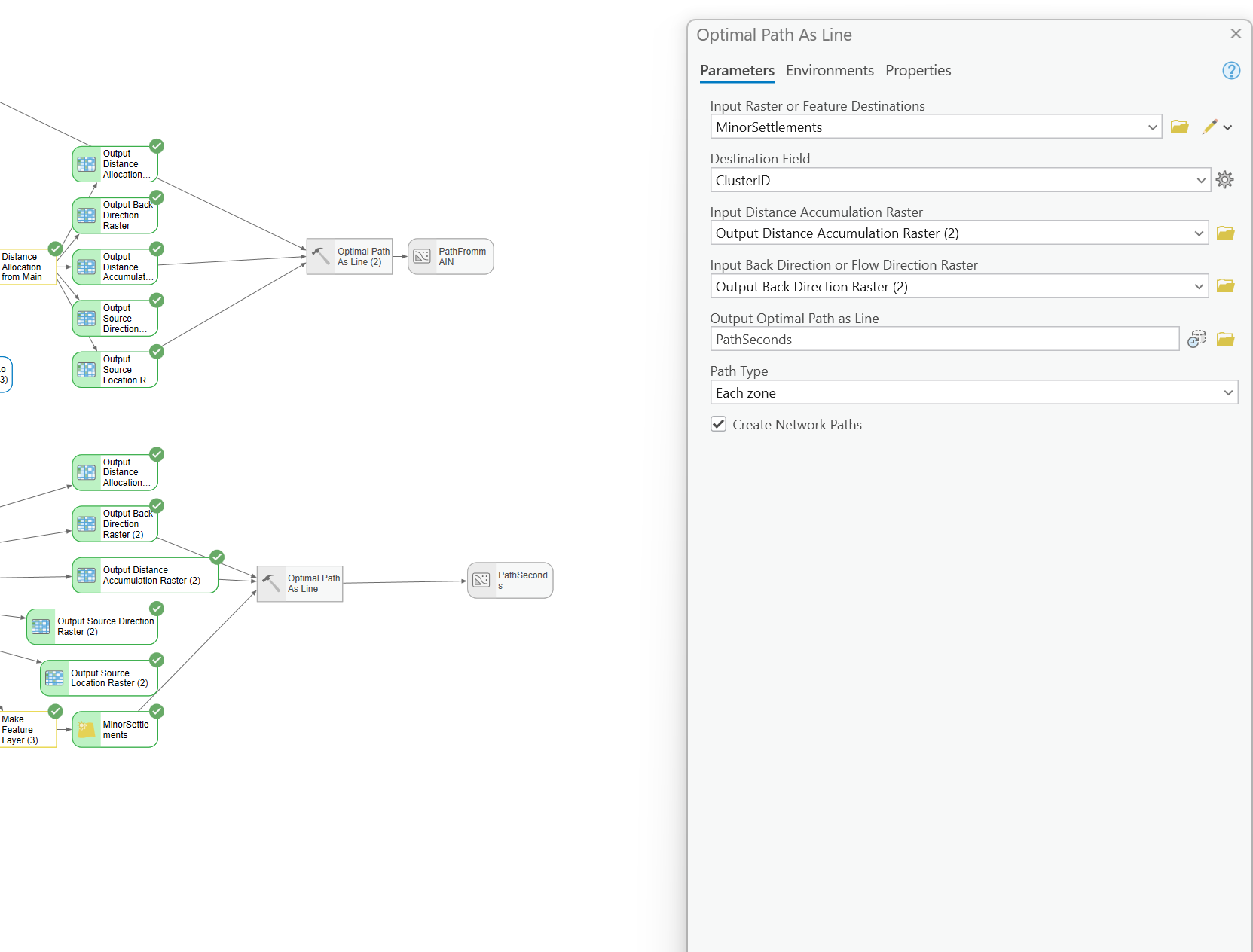

I am trying to calculate a concept of Spatial Efficiency, which is based on sum of distances for main entity to secondary entities is the equal to sum of secondary entities to the remainder.
This worked fine in spatial analyst but I having trouble
in model builder the optimal path as line will not activate
The same occurs with legacy cost path
I get this message
I need to put this into a python toolbox

# Process: Optimal Path As Line (OptimalPathAsLine) (sa)
pathFromSecondstoRest = os.path.join(arcpy.env.scratchWorkspace, "DistanceFromSeconds")
arcpy.AddMessage("About to do first path from Seconds to Minors")
optimalpathFromSeconds = arcpy.sa.OptimalPathAsLine(in_destination_data=minorCluster,
in_distance_accumulation_raster=Output_Distance_Accumulation_SRaster,
in_back_direction_raster=Output_Back_Direction_SRaster,
out_polyline_features=pathFromSecondstoRest,
destination_field="ClusterID",
path_type="EACH_ZONE",
create_network_paths="DESTINATIONS_TO_SOURCES")
instr = "Path Seconds to Minor {0}".format(optimalpathFromSeconds)
starttime = displayProgressTime(starttime, instr)

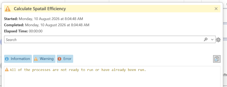

and the errors I get

arcgisscripting.ExecuteError: ERROR 010511: Internal error in cost path tracing: hr: 0x80041098.
ERROR 010423: SecBack.RASTER.1(Band_1) does not have valid statistics as required by the operation.
Failed to execute (OptimalPathAsLine).
Failed to execute (Calculate_Spatial_Efficiency).
Failed at Saturday, 8 August 2026 6:50:08 PM (Elapsed Time: 47 minutes 55 seconds)
I am stumped as to why Im having this issue?
