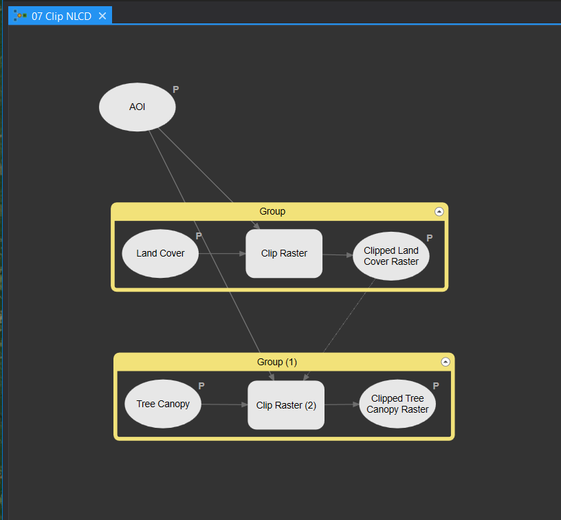

I am attempting to set up a model that will clip two separate rasters to the bounds of a polygon. The polygon is in a FC that serves as an AOI. I want to clip NLCD land cover and NLCD tree canopy to this AOI. Model is set up like so...

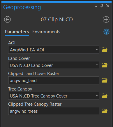

Not running/verifying the model inside the model environment because in application it will be used as a tool - see below.
I have linked the AOI variable as both the Rectangle and the Extent parameter of both Clip Raster tools. The error I am getting is  ERROR 000964: Specified extent is invalid.
When I run this outside of the model, just using the geoprocessing tool, it is successful on both rasters.

The extent polygon and rasters all need to be in the same coordinate system. You don't actually state that information, so my guess that is your problem.
