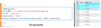

<Null> is a table's representation of None
Calculate Field example,
or as a python snippet
