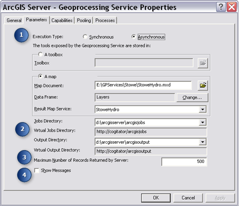

We have a geprocessing tool published with ArcGIS Server 10, and we are able to add this published tool to an ArcMap document. Running the tool with the synchronous option is fine. However, running the tool with the asynchronous option does not run. It completes as soon as you run it, with no results from the tool added to the map document.
