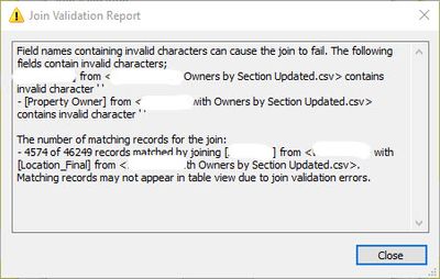

I am getting consistent error on joining 46k records from Arcmap Feature to CSV.
Field names containing invalid characters ' ' (screenshot attached for complete error)
I have done following but not luck
1. removed spaces in Excel (do i remove space in arcmap column)
2. checked text format (changed original data format in excel to text and default format didn't help)
3. removed few columns
I am joining on Location_Final Column.
Owner IDAddressCityTelephoneLocation_Final
000111731 King Street , 111th FloorMycity, AD 9055461111Sec-1 Row-2 Aisle-64
000121831 King Street East, 113th FloorMycity, AD9055460000Sec-1 Row-2 Aisle-65

convert the csv to a geodatabase table since there are some efforts made to try to cleanup such data.  Then retry the join
... sort of retired...
rajujee
Thanks Dan. I have text field to join/connect/ It doesn't fix. Any other help!
Darrin-Smith
Research removing hex characters in Excel.  These would be characters you cannot see that will definitely cause join to fail.
rajujee
Thanks Darrin. I don't find any Hex characters. Other thoughts?
