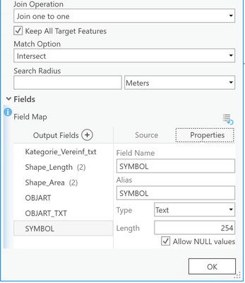

I have the same problem. I can't find this option at ArcGIS Pro. Is there any other solution at ArcGIS Pro to this?

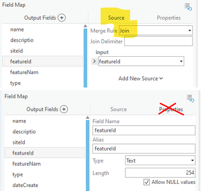

Luke_Pinner
MVP Regular Contributor
@FelixHGW click on the source tab, not the properties tab
FelixHGW
Ufff. Thanks a lot Luke!

Has there been an update to ArcGIS Pro no longer making this possible? I'm not seeing a separate "Source" or "Properties" tab, just the normal field map layout. This is using Spatial Join or Add Spatial Join.
Edit - I found out where and how to make this work! It was under the Field Map settings when you use the "Add Spatial Join" to create a new layer, not the temporary spatial join.
