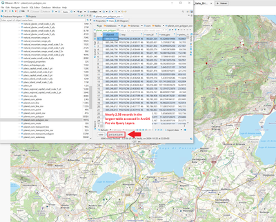

I currently run a >4TB large OpenStreetMap database as a non-geodatabase PostgreSQL database (v17.0 currently) based on Facebook/Meta's "Daylight Map Distribution for OpenStreetMap", that includes nearly all of Google Open Buildings. The hardware I use is a refurbished HP Z840 workstation that I beefed up with 20TB of NVMe disks (RAID-0), half of it serving as superfast backup, and 512GB RAM.
The largest table, containing all buildings and other Polygon geometries of OpenStreetMap for the entire planet, has nearly 2.5Billion(!) records (yes, I am using 64-bit ObjectIDs), see screenshot of DBeaver, and the actual styled data in Pro in the background as an exported PDF created by ArcGIS Pro.
