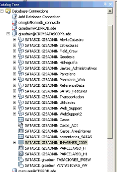

Raster Tables
How Can I know which BLK, AUX BND, RAS tables belongs to my actual raster?
If I identify this, the other blk file is from the one i delete so I can delete this table.
Does anyone knows how can I identify this?
