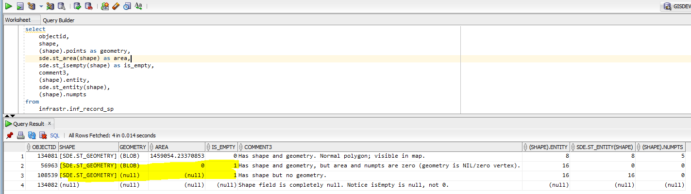

SQL testing:
select
    objectid,
    shape,
    (shape).points as geometry,
    sde.st_area(shape) as area,
    sde.st_isempty(shape) as is_empty,
    comment3,
    (shape).entity,
    sde.st_entity(shape),
    (shape).numpts
from
    infrastr.inf_record_sp
