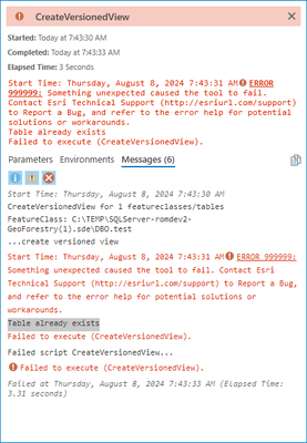

I did copy to the temp folder ,/close/open pro. i am getting the error
vijaybadugu
I tried with another database. after enabling Registered as versioned, it ran without any issues for the first time. after that, it starts throwing same error. does view register anywhere  in database ? like GDB_ITEMS
vijaybadugu
It worked. The problem is, we have to drop the view from SQL Server and run the tool to regenerate. At the same time, the name is updated in registry table.
is there a way to rename existing one and regenerate again ?
CreatingVersionedView, does it only creates a view in sql server ? After creating a view, can we rename and update manually in registrytable with an update statement?
MarceloMarques
You cannot register multi versioned views with the Geodatabase Repository. The multi versioned views are created by ArcGIS software to work exclusively with Traditional Versions. We use the multi versioned views to select and edit data via SQL statements in the Traditional Versions. You shall not rename multi versioned views, if becomes invalid, then drop the view and try to create it again. Also, you shall not try to edit the view information directly in the ArcSDE Repository Tables or you risk corrupting the Geodatabase. Note, multi version views are different from regular database views that you can register with the geodatabase, for more info about database views see the ArcGIS documentation. I hope this clarifies.

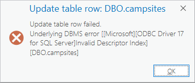

I successfully created a versioned views. I am trying to add a trigger on A' table , using update statement of versioned view, I am getting below error while editing the data in ArcGIS Pro.
MarceloMarques
this type of changes to the multi version view are not supported, the multi version view code cannot be modified manually because you will break the multi version view functionality and behavior to work with geodatabase traditional versions, you can look into adding a trigger to the featureclass base table or to the Adds Table, but that also can lead into issue when editing the data in traditional versions using ArcGIS Pro, and you will need to test the trigger extensively and make sure no issues happens after geodatabase version reconcile and post. The overall recommendation is to not tamper with the geodatabase and not try to implement logic via triggers, you can corrupt the geodatabase behavior and cause issues with traditional versioning, instead you need to use ArcGIS Pro Attribute Rules.
