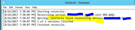

Giving the scenario a second thought, the "Reconcile Versions" tool should do the needed for you.
If you select the options of 'Abort if Conflict Detected' and 'Delete Version after post" combo, then only those versions will be deleted which have been Reconciled\Posted successfully to the Target Version selected (this part is IMPORTANT to consider) and do not have a child version of their own.
So, if you kind off just need a Report or the log details, it will have something like below in case of a conflict:

I am trying this option but not sure how would it tell if there are any edits in the version. There can be some edits but still no conflicts  against the default.
