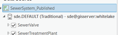

Hello,  I have enjoyed working with Branch Versioning for the past several months. For the most part using Branch Versioning is relatively simple and easy to administer.  Here is the issue I am facing and I realize that there may not be a simple solution.
Using a vpn connection to the enterprise geodatabase, it seems connections based on the containing server IP address can cause a minor inconvenience in that opening the project back up (after saving) re-sets the database connection using the same IP address with a (#) sequential number at the end.
For example: 12.200.150.24(4)
When this happens (most every time) the database needs to be re-registered with the ArcGIS Server. Again, this is a minor inconvenience. However, it seems by adding a record in the hosts file so the server's name can be used maintains the connection after saving, closing and re-opening the project.
So far so good, and this is where my issue begins:
After creating a new DB connection using the server's name and setting the new connection to Branch Versioning as well as setting and confirming the datasets and individual Feature Class to Branch Version, I use the update data source process to move the layers in ArcGIS Pro to point to the new connection.  All works well and it seems everything is in alignment EXCEPT in the table of contents, which indicates the the connection is still Traditional.  This seems to cause problems in publishing to a Portal installation.
I have tried several ideas to update this so that the connection (as shown in the TOC) reflects as being Branch.  I realize I could re-create from scratch; however, I have several database connections to process in the same manner.  Any suggestion or idea shared on how to handle this will be gratefully received.

Thanks  Marcelo,
I agree that using a VPN is NOT the best method, but for the time being, it is the method provided to me.  I use the vpn connection to set up the publish the layer(s) to the organizational Portal with version management.  Once that is done, the edits can be made through a portal connection.
I believe your comment "The Geodatabase Connection File can be set to Brach Version then you can add the layers to the map using the geodatabase connection set to branch and then your will be able to publish the branch version service." may the issue.  I am finding that once a data layer is added through a connection (traditional versioning), the connection type cannot be change.  In other words, even if the database is re-set to Branch Versioning, datasets are re-set to be managed as a branch version, and layers are re-set to branch versioning, any layers previously added to the map as a traditional version need to be re added as a branch version.
I have not come across a method to change the connection type as reflected in the TOC.  It is just a few steps to do re-add layers and such, but with 15 or more databases, I just wish it could be easier.
Thanks again.  James
