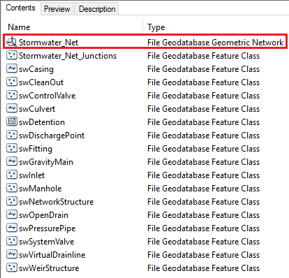

From what I understand you just need some selected Feature Classes and the Domains...you don't want the Geometric Network. Let me know if the understanding is incorrect
The below is a screenshot of what the geodatabase contains. Create a copy of the File geodatabase and then just Right-Click on the data that you don't want and delete them.
johncoon
Asrujit SenGupta,
Thank you, I think I've got it thanks to your help.
