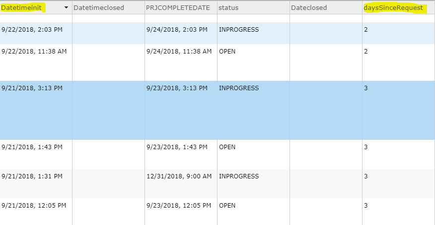

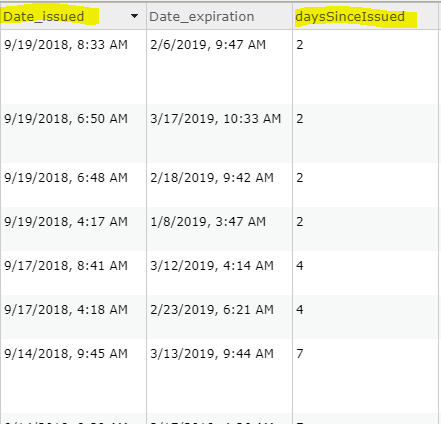

Excerpt from above where I'm seeing a difference
/*This acts as a static field which is not how I would expect*/
iif(a.date_issued IS NULL, NULL, DATEDIFF(DAY, a.date_issued, GETDATE())) AS daysSinceIssued
/*This acts how I would expect as a dynamic field and keeps the values up to date*/
DATEDIFF(DAY, datetimeinit, GETDATE()) AS daysSinceRequest‍‍‍‍‍
results as a service:
   This query correctly updates the daysSinceRequest field (today's date 9/24/2018)
Query that correctly updates the days since Request (Today's date 9/24/2018)
This query does not correctly update the daysSinceIssued field (today's date 9/24/2018)
Query that does not correctly update the days Since Issued field (Today's date 9/24/2018)
