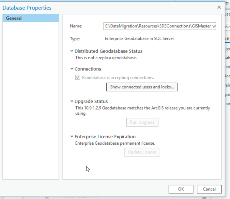

We are using Microsoft SQL Server 2019 (RTM-GDR) (KB5014356) - 15.0.2095.3 (X64)   Apr 29 2022 18:00:13   Copyright (C) 2019 Microsoft Corporation Standard Edition (64-bit) on Windows Server 2019 Standard 10.0 <X64> (Build 17763: ) (Hypervisor) and geodatabase details as below.
We have been reviewing our performance and noticed there are few long running queries as below.  Our database is set for MAXDOP 8 and the cost threshold for parallelism = 80 . The cost of the long running queries  is higher but does not seem to be using parallelism and using OPTION (MAXDOP 1). Do we need to make any configuration changes here ? We have installed all ArcGIS Enterprise patches.
