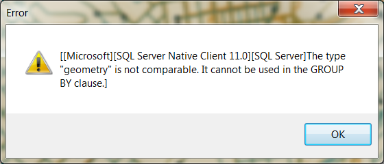

Here is the error....

It isn't working because SQL Server Geometry or Geography types cannot be used in a GROUP BY clause.  What version of SQL Server are you using?  If 2012 or higher, you can use Static Aggregate Geometry Methods to incorporate "grouped" spatial data into query results.
