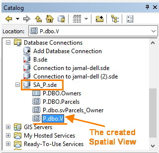

I’ve created a spatial view in SQL Server 2014 in an enterprise geodatabase. When viewing this view in ArcMap, it acts as if it is in a non-spatial database (However, the database is enabled as enterprise geodatabase).

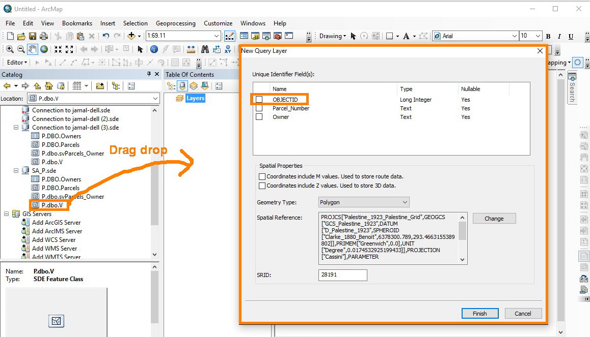

When adding this view to the dataframe, it asks about the ObjectID field, despite the fact that this filed is already available.

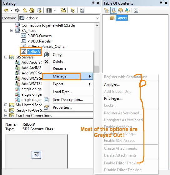

Moreover, all the enterprise management tools are greyed out (register as versioned, add global IDs,…..)

This is better elaborated with the screenshots below,

To explain in brief....Starting from ArcGIS 10.1, Database Views can be created using ArcGIS Desktop, which like normal Views created from Database end, are not 'Registered with Geodatabase' or 'Registered with SDE'. This is why ArcGIS requests you to choose the Unique Identifier when you add the View to ArcMap. Instead if you create the View with SDE Command line tools, it automatically registers the View with ArcSDE and doesn't request you to choose the Unique Identifier.
The other scenario, where other than Analyze and Privileges, all other options are greyed out, that is expected as well. You cannot register a Database View as Versioned or do the other stuff listed under Manage. Have a look at the Online Links for more info.
